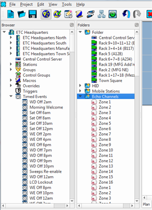

Folders is provided as an alternative user customizable Browser. Folders, by default, is found in a tab located behind the Browser.
You may relocate the Folders tab by docking to another location in the application window pane, reference Application Window Panes.
Using Folders
A "Folder" is a container for user configurable Browser tree objects including; channels, stations, walls, processors, groups, control groups, Macros, overrides, triggers, timed events, presets, palettes, sequences and even spaces.
When the Folders pane is moved into a floating position or docked into a different location of the application display, you can easily drag objects from the Browser into a folder within the Folders pane.

- Right-click inside the white space in the "Folders" pane and select "Create Folder" from the context menu.
- Click to select the new folder
, and rename it to a unique name using any of the following methods:- With the new "Folder" selected, press [F2], type the new folder name and press [Enter].
- With the new "Folder" selected, use the Property Editor to change the name.
- Right-click on the folder and select "Rename" from the context menu. Type the new name and press [Enter].

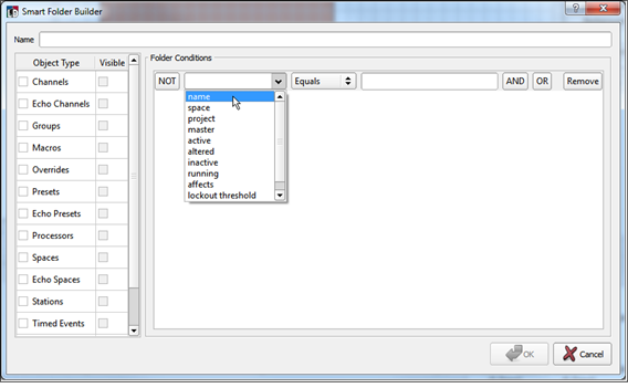

A "Smart Folder" is a dynamically updated folder of user customized Browser objects. The type of objects that may be included into a Smart Folder include channels, groups, macros, overrides, presets, processors, spaces, stations, timed events, and walls. Certain conditions of these objects can be applied as the filtered data of the object.
Smart Folder Builder
The Smart Folder Builder is a dialog that displays to create Smart Folders and Child Smart Folders. Begin creation of either by providing a unique name in the "Name:" field provided.
"Folder Conditions" are specific filter criteria that is applied to the selected object type(s) in the Smart Folder Builder. Selecting the [NOT] button for a folder condition provides additional filtering by exclusion.

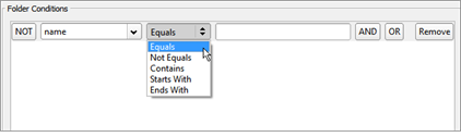

- the name condition filters the name of the selected object, using text matching
- the space condition filters the selected objects by inclusion within a Space.
- the project condition filters the selected objects by inclusion within a space.

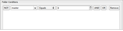

- the master condition filters the active master value for selected group and/or space objects
- the active condition: filters the status of the selected objects based on their active status
- the altered condition filters the status of selected object based on its altered status.
- the inactive condition filters the status of the selected objects based on their inactive status.
- the running condition filters the macros based on their status.
- the affects condition filters presets based on whether they affect any channels within a selected space or project
- the lockout threshold condition filters stations based on their lockout level.

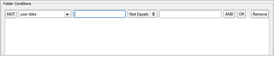

- the user data condition allows filtering of objects based on the user data tag and the meta-data value.

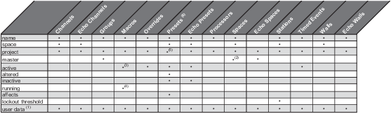

Not all "Folder Conditions" are applicable to all Object Types. The table below identifies which conditions are applicable to each other.
Notes:
- "user data" is a pseudo property that looks for the meta-data tag in the object, including custom user defined tags, as well as the default "User Data x" tags that are automatically generated by LightDesigner.
- "master" is a raw value where 65536 is full and 0 is off.
- A macro is active if it is running steps or, for toggle macros, has run the "On" steps but not completed the "Off" steps.
- A macro will display as "running" when it is currently in its "On" or "Off" steps.
- Presets will use their space's project name to test against the filter.
- Presets include palettes and sequences. Sequences will be expandable to show their steps.
