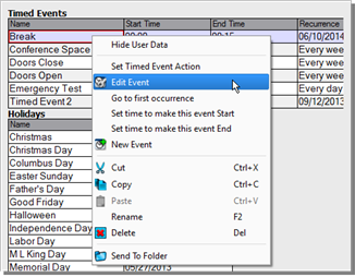

Timed Events
Lists all timed events in alphabetical order. From this report, you can select the event, and view or set specific timed event properties using the Property Editor, right-click on the event and select actions from the provided context menu.
