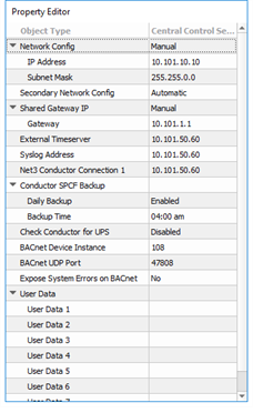

Selecting the Central Control Server from the Browser displays its properties in the Property Editor.
Note: A Paradigm Central Control Server (P-CCS) defaults IP settings of "Manual" with IP address 10.101.10.10, Subnet Mask 255.255.0.0 for the primary lighting interface.
Tip: If "Automatic" is the selected address method, this means that Link Local IP settings are used when no DHCP service is found on that interface.
Note: This property defaults to 0.0.0.0, which means the Net3 Conductor Network Services Gateway is the NTP master. Configuring another IP address for this property instructs the P-CCS to use a different external time server.
Note: All Paradigm products, by default, participate in Net3 logging (mainly for errors).
