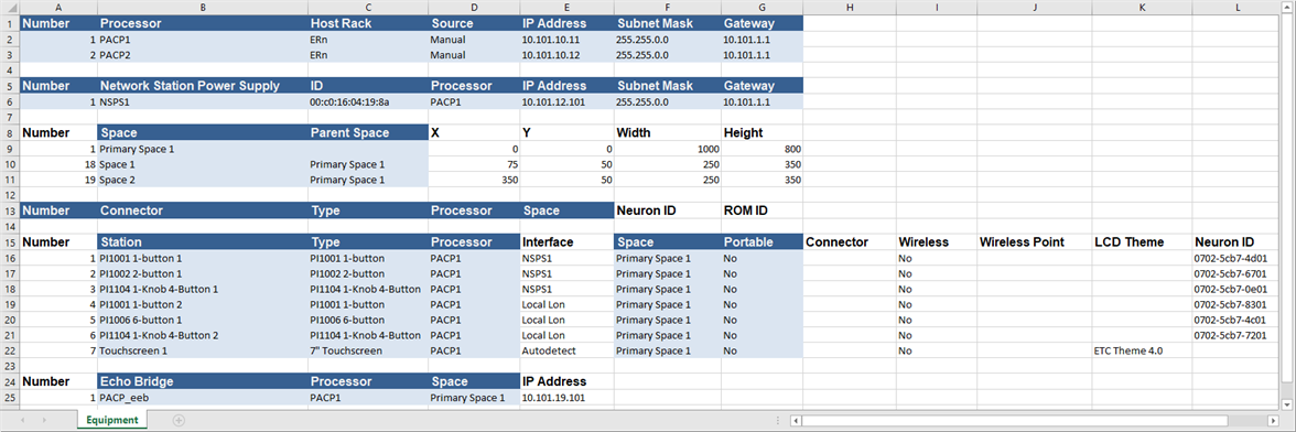

Equipment List Spreadsheet Formatting
At a minimum, the equipment import spreadsheet must include Processor and Space data. You may include additional equipment in the import including Network Station Power Supplies, Connectors, Stations, Echo Bridges, and Mosaic Shows. The equipment list spreadsheet must be formatted in a very specific way for a successful import.
Each import object type has required minimum data for a successful import. An equipment import may be simple or complex depending on which information you are importing.

Processor
You must include the Processor Name, Processor Number, Host Rack, and IP settings.
Space
You must include the Space Name, and Parent Space Name if the space is within a sub-space. You can additionally create and modify space data through the import process and create project hierarchy through primary space and sub-space.
Network Station Power Supply
You can create and modify Network Station Power Supply data through the import process. The minimum data required for a NSPS import is the NSPS Number, Name, ID, Processor, and IP Settings.
Connector
You can create and modify connector data through the import process. The minimum data required for a Connector import is the Connector Name, Number, Type, Processor that it is assigned to and the Space where it is located.
Station
You can create and modify station data through the import process. The minimum data required for a Station import is the Station Name, Type, Processor that it is assigned to, the Space where it is located, confirmation of whether it is a Portable (Yes or No) or Wireless, and the LCD Theme where appropriate.
Note: The station type is the stations short name as found in LightDesigner, the root name of the station as it is indicated in the Station Library, e.g. PI1104 1-Knob 4-Button, UH1001 1-Button (1 Gang), or 7" Touchscreen.
Additional properties that can be supplied for a station includes the Interface, Connector, etc. If no Interface is specified for the station, it will import into the configuration with [Autodetect] as the default setting.
Echo Bridge
You can create and modify Echo Bridge data through the import process. The minimum data required for Echo Bridge import is the Echo Bridge Name, Processor that it is assigned to, and the Space where it is located.
Mosaic Show
You can create and modify Mosaic Show data through the import process. The minimum data required for Mosaic Show import is the Mosaic Show Name and Processor that it is assigned to.
