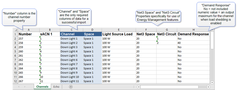

Load Schedule Spreadsheet Formatting
The load schedule spreadsheet can have as much data and formatting as you require for your personal use, so long as the columns of the imported data have the required keywords that all begin on the same row. The order and sequence of the columns are insignificant.
Note: Data included in the load schedule spreadsheet formatting that is not needed for the load properties or that falls outside of the required formatting for successful import will be ignored by the import process.
Importing by Number Data versus Channel and Space Data
Channel and Space are the only required columns of data for a successful load schedule import. In the sample load schedule provided below, the Number column is the channel number property.
If you choose to include the Number data in an import, a dialog will display for confirmation of whether you prefer to import the load schedule matching the data by the Number or by the Name and Space.

User Data
Any extra columns of User Data to be imported should be designated using parenthesis around the column header, for example (My Channel Notes). All provided row data will import with a valid column header. In addition, when imported, the provided header name overwrites the User Data label in the Property Editor.

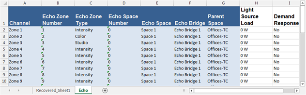

Echo Expansion Bridge
A second tab in the import load schedule spreadsheet can be included for Echo Expansion Bridge configuration data.
The data columns must include the following headers and supporting data for a successful import:

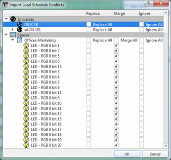

Importing Conflict Dialog
The import process could result in a conflict with pre-existing configuration data causing a "Import Load Schedule Conflicts" dialog to display for specification of replace, merge, or ignore. There are multiple reasons a conflict can occur, with a main reason being a duplicate object of the same name; importing a file twice will not create the objects in duplicate. Instead you are provided with a conflict dialog for disposition of which version of the same object you would like to maintain.
You can submit an action per conflict or a set an action that will manage all conflicts at once.
After the import is completed successfully, there may still be errors incurred by the import. Check the Error Browser for a list of any incomplete assignments that may affect the configuration.
