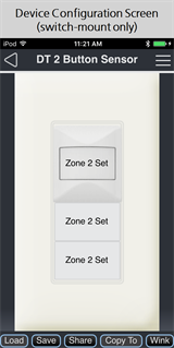

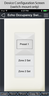

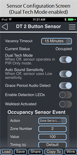

When you choose to configure an Echo Dual Tech Switch-mount Occupancy Sensor with the EchoAccess Mobile App, a representative image of the selected sensor will display including labels for the currently configured sensor and button assignments (below left). Tapping the sensor (top) will bring you to the sensor configuration screen shown below right. To configure buttons on the switch-mount occupancy sensor, see Configuring Buttons (Switch-mount Occupancy Sensors Only). Configuring an Echo Dual Tech Ceiling-mount or Wall-mount Occupancy Sensor will take you immediately to the sensor configuration screen shown below right.
Use the available drop down menus and keypad to specify the desired configuration information.
Note: To configure an Echo Dual Tech Occupancy sensor with the EchoAccess Mobile App, the sensor must be in Custom mode. To enable Custom mode, locate the DIP switch on the circuit board of a ceiling-mount or wall-mount station or the Function switch under the faceplate of a switch-mount station.
  • Current Status (read only) - shows current status (either Vacant or Occupied) of the sensor.
  • Dual Tech Mode - use the toggle switch to enable or disable Dual Tech Mode. When Dual Tech Mode is disabled, the sensor operates in PIR Only Mode.
    • Auto Sound Sensitivity - use the toggle switch to enable or disable automatic sound sensitivity. When this setting is enabled, the sensor will automatically adjust sound sensitivity. When this setting is disabled, the sensor will use Low sensitivity.
    • Grace Period Audio Detect - use the toggle switch to enable or disable sound detection during the grace period.
  • Enable Detection LEDs - use the toggle switch to enable or disable the red detection LEDs. If enabled and occupancy is detected, the detection LEDs illuminate with each detected occupancy motion.
  • Walktest Activated - use the toggle switch to enable or disable the sensor's walktest feature. When walktest is enabled, physically walking through the space confirms the PIR functional sensor range, illuminating the red PIR LED with each detected occupancy motion. If audio detection is enabled, the green LED will illuminate when audio is detected.
  • Occupancy Sensor Event - use the drop down menu to set the event Action that will take place when vacancy is detected.
    • Available actions include Closed No Function, Preset Activate, Zone Set to Level, and Space Set to Level. Additional menu options will display based on the Action selected (e.g., if the Action is set to Preset Active, Preset Number and Timing (in seconds) displays for specification.
  • Vacancy Sensor Event - use the drop down menu to set the event Action that will take place when vacancy is detected.
    • Available actions include Closed No Function, Preset Activate, Zone Set to Level, Space Off, and Space Set to Level. Additional menu options will display based on the Action selected (e.g., if the Action is set to Preset Active, Preset Number and Timing (in seconds) displays for specification.

When you configure an Echo Dual Tech Switch-mount Occupancy Sensor with the EchoAccess Mobile App, a representative image of the selected station will display including labels for the currently configured button assignments and occupancy sensor assignment.
Tap on a button to configure its actions. To configure the occupancy sensor, see Configuring the Occupancy Sensor. The selected control's Configuration page displays.
Note: To configure an Echo Dual Tech Switch-mount Occupancy station with the EchoAccess Mobile App, the Function selection switch located under the faceplate must be in the Custom (middle) position.
Use the available drop down menus and keypad to specify the desired configuration information. Additional configuration options will display depending on the selected action. For example, if the Push Action is set to Preset Toggle, Preset Number and Timing(s) will display for additional specification.
