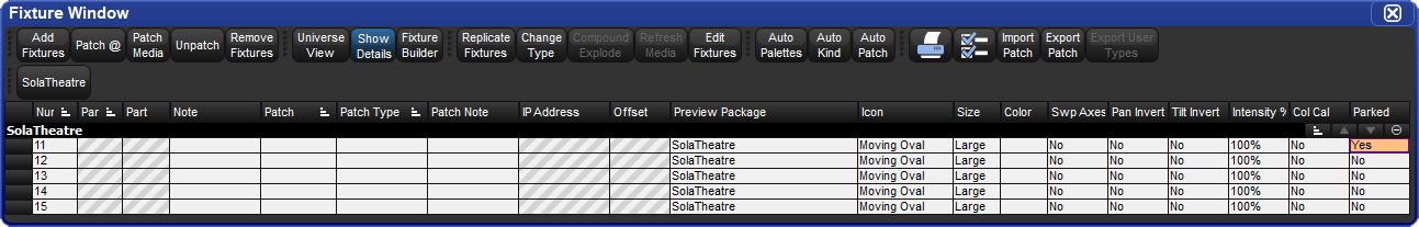

The Fixture Window
To view which fixtures have parked parameters in the Fixture window:
Figure 16.3. The Parked column of the Fixture window
Screenshot fragment showing the parked column of the fixture window, with some fixtures parked

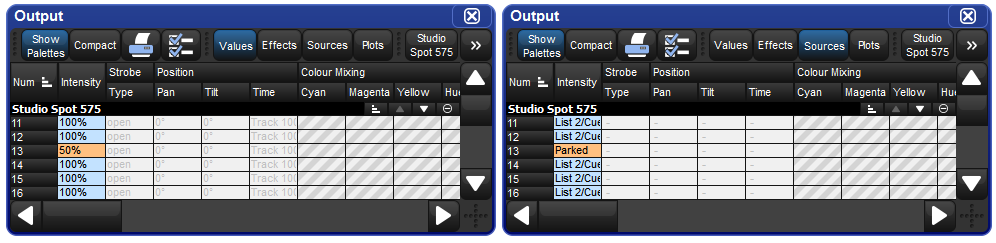

The Output Window
Parked parameters are shown in the Output window with black text on an orange background. When the Output window Source view is selected the word ‘Parked’ is displayed.
Screenshot fragment showing parked parameters in the output window

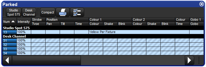

The Parked Output Window
You can view and modify the parked settings of fixtures in the Parked Output window; see Figure 16.4, “The Parked Output window”. To open the Parked Output window:
  • Open + Parked : the Parked button is on the toolbar that appears when you press the Open key.
Within this window you can edit parameter values in the same way as in any editor. You can knockout fixtures or parameter values to stop them being parked, or add or modify parameter values to park them.
Figure 16.4. The Parked Output window
