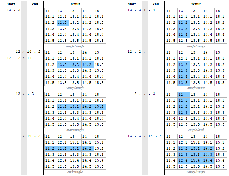

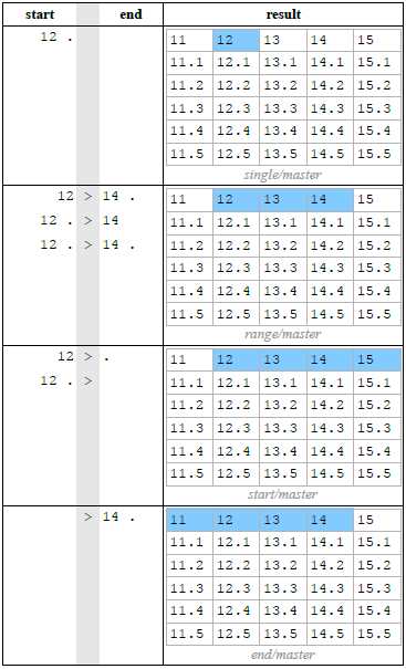

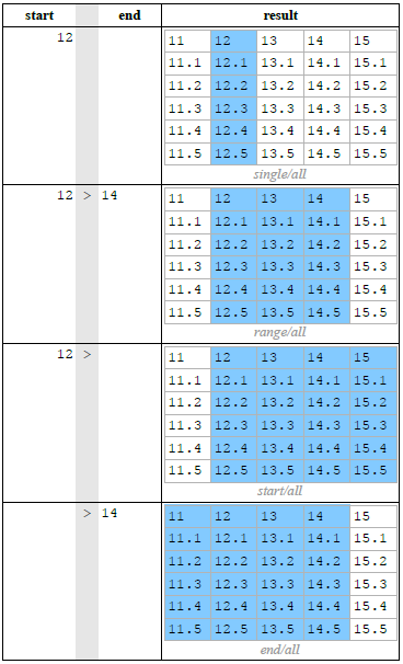

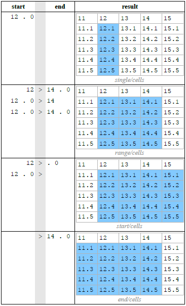

6.1.3 Selecting fixtures with dotted user numbers
Selecting fixtures with dotted user numbers can be done in a variety of ways. The tables listed in this section demonstrate all of the supported selection syntax mechanisms supported by the Hog 4 OS for fixtures with dotted user numbers.
The following examples assume all of the fixtures on the right hand side of the table are scheduled in the show while the user numbers highlighted in blue are fixtures that have been selected as a result of the syntax entered on the left hand side of the table:
Figure 6.1. All Portion Selections
All Part Selections
Figure 6.2. Whole Portion Only Selections
Figure 6.3. Part Portion Selections
Figure 6.4.  Part Portion Selections with .0
[Tip]Tip
Open ended fixture selections stop when a break (gap) in the whole portion of the user numbers is detected. In addition, open ended selections made within a range of part number portions will stop if a break (gap) is discovered in the part number portion of the selection.
