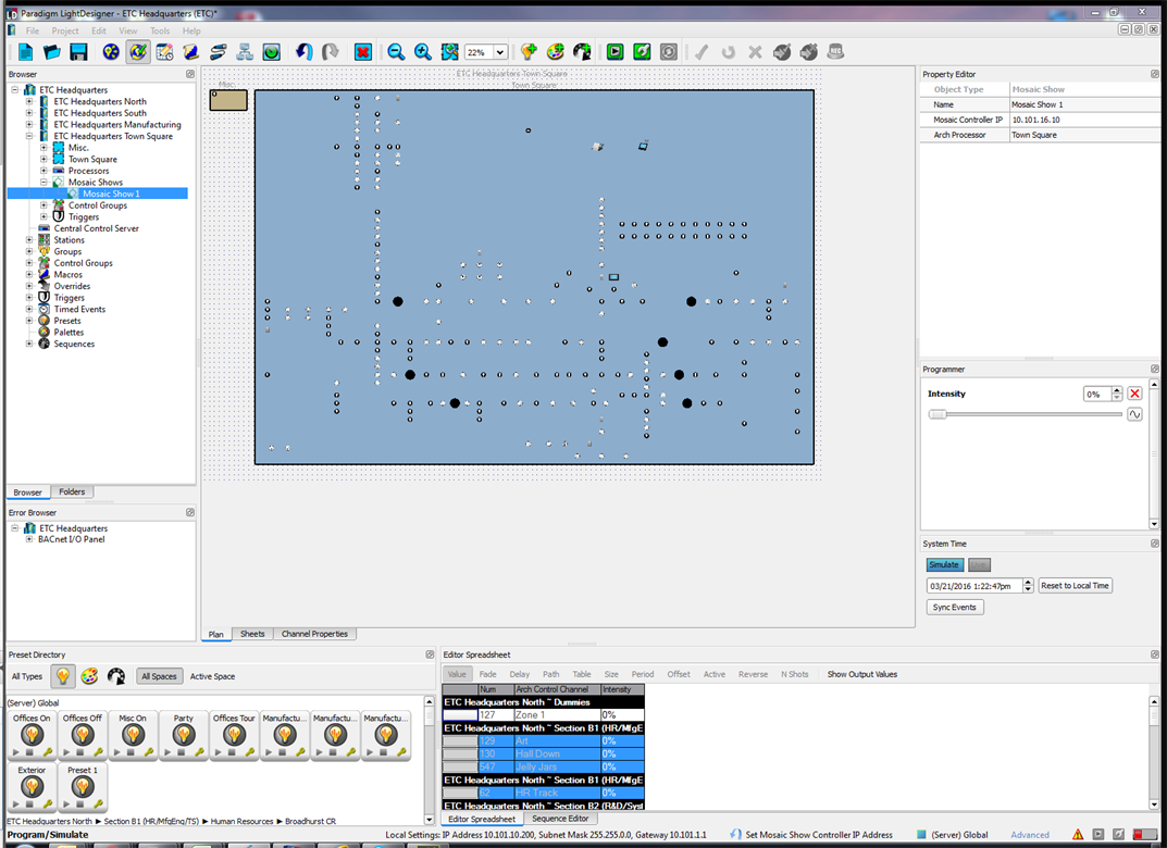

Add Mosaic Show(s) to the LightDesigner Configuration
Each project in LightDesigner offers a "Mosaic Shows" node directly beneath the Processors node in the Browser. For Server projects Mosaic Shows are added to sub-projects, they cannot be added at the server level.
- Right-click on "Mosaic Shows" node in the Browser and select "Add Mosaic Show" from the context menu. A Mosaic Show is added to the Browser and provided a default name (for example Mosaic Show 1, Mosaic Show 2, etc.). By default the controller is automatically associated to the Paradigm Processor with the lowest processor ID for that project (Processor 1, for example).
- Select the new Mosaic Shows node in the Browser and use the Property Editor to configure these necessary properties:
- The IP address of the Mosaic Show Controller that is the time server of the Mosaic Show you are interacting with. In a system with multiple Mosaic Controllers this will be Controller 1 (by default). The IP address of the Mosaic Controller is configured using Mosaic Designer software.
- If desired, change the Name of the controller from its default.
- If desired, change the Arch Processor that the Mosaic Show is associated. Available processors in the project will appear in a drop down menu when the property is selected.
![](../Resources/Images/ss_add_msc.png)
- Save the LightDesigner configuration file.
