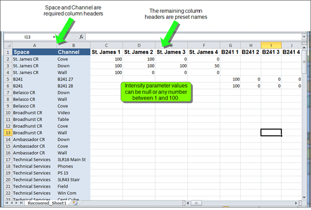

Presets Spreadsheet Formatting
The Presets spreadsheet in *.ods format, must be organized with specific column headers ("SPACE", "CHANNEL" and any preset names should be represented) on the same row. The order of columns is not important so long as they are all on the same row. Reference the sample spreadsheet below which was previously exported from LightDesigner.
Tip:  The best way to create a valid spreadsheet for importing presets and their intensity data is to begin from an exported and already formatted *.ods spreadsheet created by LightDesigner. Try exporting presets from an existing LightDesigner configuration first, then edit the data to match your project needs.
Note:  The Preset import feature is a tool used mainly for creating new or editing existing presets; therefore the space and channel names should match an existing space or channel name in the configuration you are importing into. If they do not, LightDesigner will do its best to create the new space and channel for you during the import process.
