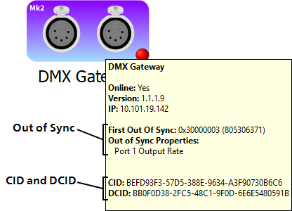

Out of Sync - A red dot in the lower right-hand corner indicates the information Concert has is different to the information in the networked device.

Hovering the mouse pointer over a device icon displays additional information about that device in a tooltip. When the device you are hovering over has properties that are out of sync between the network and the physical device, those properties are identified within the tool tip.
Note: CID and DCID information displays in the tool tip only when the preference for display is selected.
