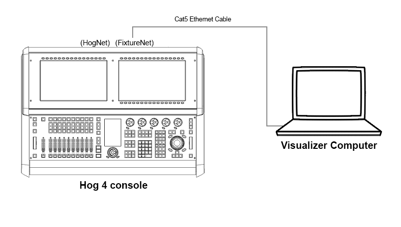

28.3 Physically Connecting the Console to the Visualizer
Connect the console's FixtureNet port to any Ethernet port on the visualizer PC using a
standard Cat5 or Cat6 Ethernet cable. Switches and routers can also be used
inline to connect the console to the visualizer PC.
