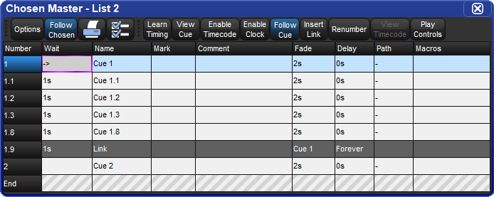

To create a loop, you need to have two things:
A link that points to a cue earlier in the cuelist.
All the cues in the loop (between the linked-to cue and the link cue) must be assigned with wait or follow triggers; see Cue Wait Timing.
Hog 4 OS will recognise this as a loop; see Figure 13.11, “A Cuelist with a Loop”.
You can determine when the cuelist stops looping and continues with cues after the loop. The options are:
Forever: the loop will run indefinitely until you press the Go key.
Count: the cuelist will loop the assigned number of times. Assigning a count of zero will make the cuelist ignore the link.
Timed: the cuelist will loop until the assigned time period has elapsed.
To assign the looping behaviour:
Open + [Cuelist 1] : open the cuelist window.
Select the link cue's Delay cell, and press Set.
Select an option from the Loops Toolbar:
If you have selected Count or Timed, enter a count or timed value.
