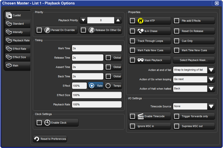

17.5 Master Playback Options
The priority, timing, and other various properties of a master that affect how it is played back are configured using the master's Playback Options window. This is the same for all master types (cuelist, scene, batch, group).
  1. Open + Choose : opens the Master window.
  2. Options : opens the Master's Playback Options window.
Alternatively, you can quickly access many of the master options from the options toolbar by holding down the Choose key of the master:
The options toolbar
[Tip]Tip
You can quickly open the playback options for a master by holding the Pig key and pressing the master's Choose key.
Figure 17.6. The Cuelist Pane of the Playback Options Window
The cuelist pane of the playback options window
You can configure the default playback options for new cuelists, scenes, and batches in the User Preferences window:
You can also customise the function of each of the master controls and main controls; see Physical Master Playback.
[Tip]Tip
You can revert all of the playback options of the Cuelist, Scene, or Batch tab by pressing the Reset to Defaults button in the bottom left corner of the window.
17.5.1 Master Timing and Rate Settings
You can assign several settings that control cuelist timing:
Timing Function
Default
Notes
Release Time 2s
The time over which parameter values go to their default values when the cuelist is released; see Releasing Masters. Using the [global] option will refer the cuelist to use the global release time established in the show manager window under the show settings tab.
Assert Time 2s The time in which parameters go to their values determined by the cuelist when the cuelist is asserted; see Asserting One Cuelist Over the Others. Using the [global] option will refer the cuelist to use the global assert time established in the show manager window under the show settings tab.
Back Time 2s The time in which the cuelist steps back to the previous cue when the Halt key is pressed twice (to first halt the cuelist and then send it back). Using the [global] option will refer the cuelist to use the global back time established in the show manager window under the show settings tab.
Playback Rate
100%
Default proportion rate of the cuelist. A rate of 50% will double all cue timings, a rate of 200% will halve all cue timings.
Cue Only
Off
Releases previous cue's tracking values as you advance the list to the next cue. Tracking values are released using the total fade time of the cue being played.
[Tip]Tip
If you have assigned a release, assert or back time to a cuelist, and you want to revert to the default time, press the Default button adjacent to the appropriate cell.
17.5.2 Cuelist Wrapping
Wrapping decides what happens to a cuelist when it reaches the final cue. Configure the wrapping in the Action at End of List menu:
  • Wrap to beginning of list: Pressing Go after the final cue is reached sends the cuelist to its first cue.
  • Add release end cue: Pressing Go after the final cue is reached releases the list and sends it to its first cue.
  • Auto-release at end: The cuelist is released as soon as the last cue in the cuelist has completed all its fade and delay times.
  • Don't allow wrapping: The cuelist stays on the final cue until released or sent backwards.
17.5.3 Cue Only
Cue Only enables a cuelist to playback cue data one cue at a time (otherwise known as a non-tracking cuelist). For example: any cue data in cue 1 is released as you play cue 2 so that only data from cue 2 is onstage. The release time of the previous cue is determined by the longest fade time in the cue being played.
17.5.4 Action of go when Looping
When the cuelist is performing a continuous loop with the use of a link cue, you can configure the effect of pressing the Go key using the Action of Go When Looping menu:
ActionNotes
Exit loop immediately Jumps the cuelist to the link cue at the end of the loop. Use a wait time on the cue after the link if you want to go to that cue automatically when exiting the loop.
Exit loop at end
Allows the loop to proceed to the last cue before jumping to the link cue at the end of the loop. Use a wait time on the cue after the link if you want to go to that cue automatically when exiting the loop.
Restart
Jumps immediately to the first cue in the loop.
Stop at next
Stops at the next cue in the loop.
Go Next
Advances the cuelist forward by a single cue when go is pressed.
For more information on loops, see Loops and Links.
17.5.5 Action of Halt when Halted
By default, pressing the Halt key when a cue is halted steps the cuelist back a cue in the assigned back time, see Master Timing and Rate Settings. You can change this action using the Action of Halt When Halted menu:
Action Notes
None The current cue remains halted.
BackThe cuelist crossfades into the previous cue using the back time assigned to the cuelist.
Resume
The current cue continues to fade.
Release
The cuelist is released, see Releasing Masters.
Toggle FX
Toggles effects between running at 0 BPM and the programmed rate
