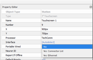

Using the 7" Touchscreen configured for Portable Installations
When using the 7" Touchscreen in a portable installation, you must select the type of portable installation for the space. With the 7" Touchscreen object selected in the Plan workspace, use the Property Editor to set the Portable Wired property for the 7" Touchscreen to "Yes: Connector List" or "Yes: Ethernet".
Portable Touchscreen Station Property
When "Yes: Connector List" is selected, you must add an instance of the Portable Connector (UH1RS) station and an instance of the 7" Touchscreen to each desired space of control.
To disable a portable connector for the selected 7" Touchscreen, click the "Enabled" property for the selected connector. Because each instance of the 7" Touchscreen is assigned a touchscreen configuration, that configuration and theme will load onto the touchscreen when it is connected to the related portable connector.
