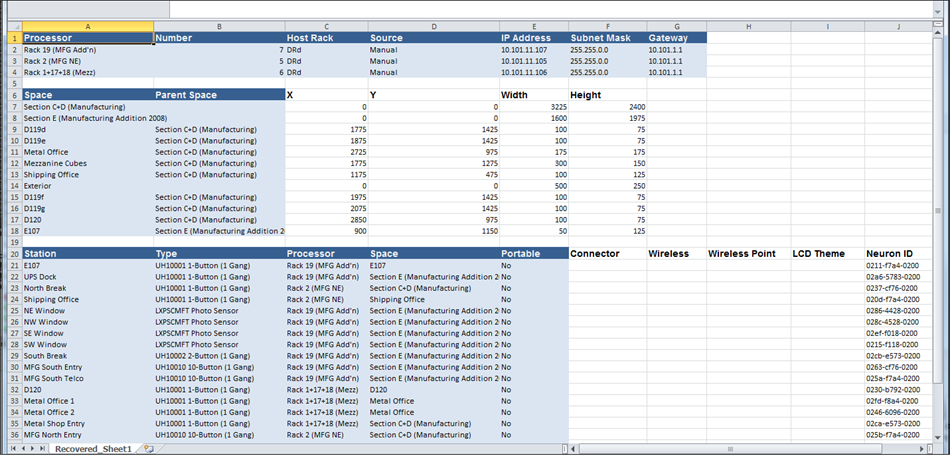

Tip: The easiest way to create a valid equipment list for importing, is to begin from one. Try exporting an equipment list from an existing LightDesigner configuration first, then edit the data to match your new project needs.
Reference the sample equipment list below that was previously exported from a LightDesigner configuration:
A valid and importable spreadsheet requires the following sections of data:
Note: Even if the project does not include stations, the column headers must be present in the spreadsheet.
