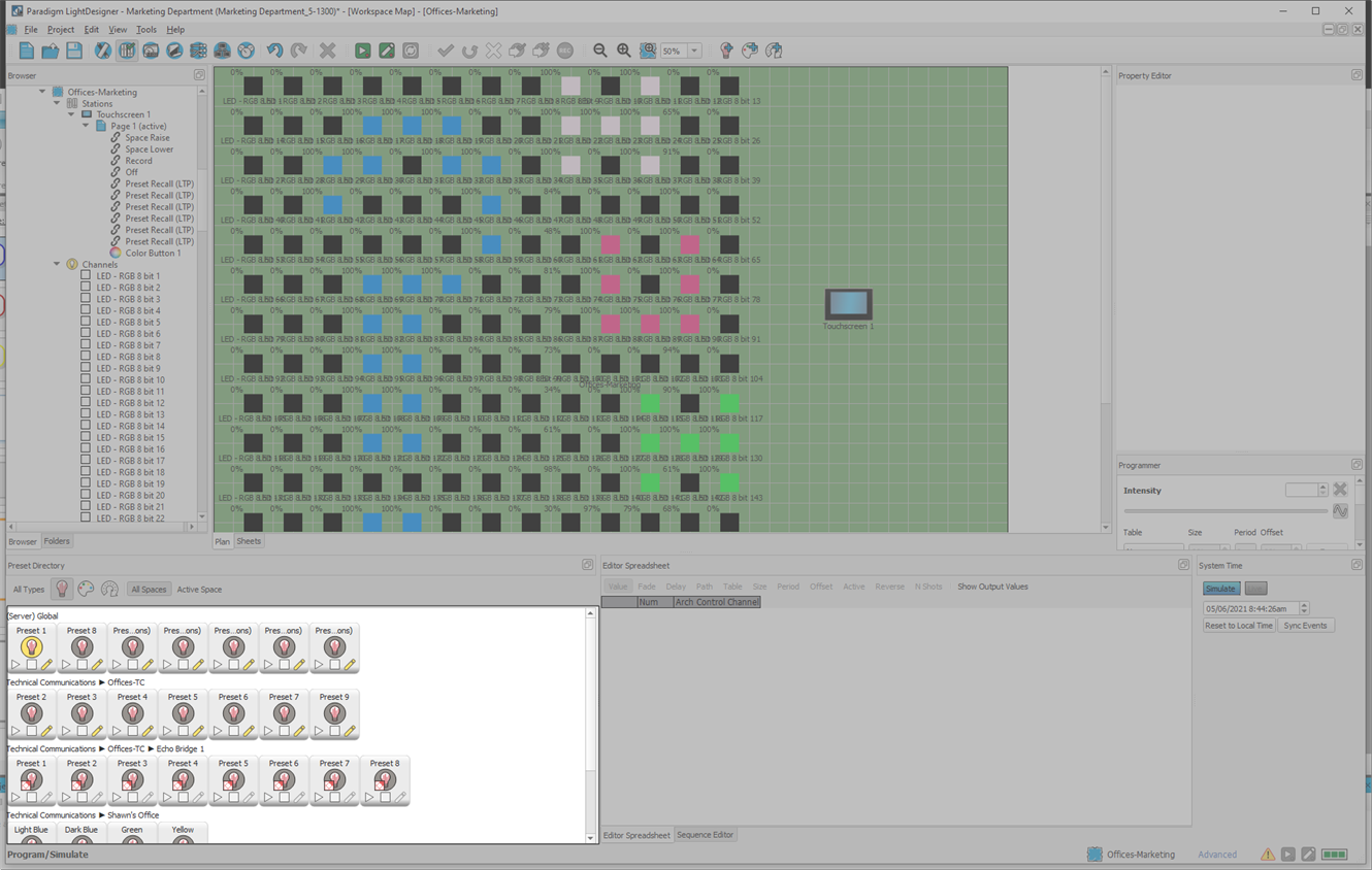

The Preset Directory is displayed only in Program/Simulate view. The Preset Directory is a repository of all presets, palettes and sequences in the entire project, selected space or active space depending on the settings.

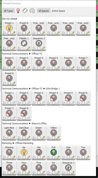

Click the [All Types] button to display all presets, palettes and sequences that are in the project (or server project). Click the [Presets] button to display only presets in the directory. Click the [Palettes]
button to display only palettes, or click the [Sequences]
button to display only sequences in the Preset Directory.
You can additionally filter the objects that are displayed in the Preset Directory by selecting either the [All Spaces] or [Active Space] button.
In the above example, both [All Types] and [All Spaces] is selected. Notice that the objects are sorted by space, starting with the "(Server) Global" project, at the top, then moving down the project list including all primary and sub-spaces. If instead, the [Active Space] button was selected, the directory would show only the objects that are in currently selected space.
By default, presets, palettes and sequences are displayed in the Preset Directory by the space they affect.
Depending on the display and filter criteria set as well as the Preferences set, the Preset Directory could display an entire space hierarchy path. When "Show spaces hierarchy in sheets and tables" is set in Preferences, the primary space is listed first, followed by the sub-space, and then the area. This is true for as many levels as are configured. Alternatively, the breadcrumb can be set to show only the primary space and sub-space by disabling the feature in space preferences.

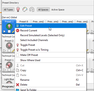

Right-click on a Preset, Palette or Sequence in the Preset Directory and choose "Select Included Channels" from the context menu. All channels that are included in that object will be selected and display in the Editor Spreadsheet as well as in the Plan, or Sheets view that is in focus.

Right-click on a Preset in the Preset Directory select "Toggle Preset" or "Toggle Preset w/o Timing".

Right-click on any Preset in the Preset Directory and select "Make Off Preset" from the context menu.
The selected preset will indicate "OFF" in the top left corner of the icon in the Preset Directory .

First set the values desired for the selected channels, and then right-click on the desired preset icon in the Preset Directory and select either "Record Current" or "Record Simulated Levels (Selected Only)" from the context menu.
LightDesigner will store the values in at their current levels into the selected preset.
