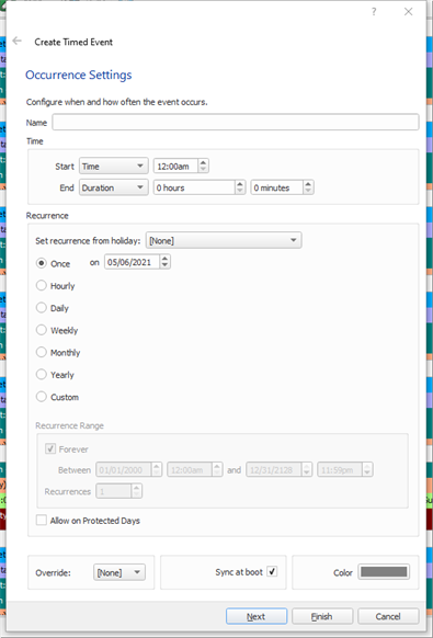

  1. Click the New Event button in the main toolbar. The "Create Timed Event" dialog displays.
  1. Specify the new timed event name.
  2. Specify when and how often the new event occurs.
    1. Select whether the Start period will use "Time", astronomical settings ("Sunrise" or "Sunset") or determined by another "Event Offset" from the drop down menu.
      • If "Time" is selected, specify the specific time of the event in hours and minutes. The clock displays according to the clock preferences set, either 12 hr or 24 hr.
      • If "Sunrise" or Sunset" are selected, specify the hours and minutes offset from the specified astronomical setting the event will take place.
      • If "Event Offset" is selected, specify the event that will trigger this new event from the "Event" drop down. Include offset if required.
    2. Select whether the End period will be timed, a "Duration", "Time", astronomical setting ("Sunrise" or "Sunset") or an "Event Offset" from the drop down menu.
      • If "Time" is selected, specify the specific time the event will end in hours and minutes. The clock displays according to the clock preferences set, either 12 hr or 24 hr.
      • If "Duration" is selected, specify the hours and minutes the event will run and before the end event will play.
      • If "Sunrise" or "Sunset" are selected, specify the hours and minutes offset from the specified astronomical setting when the start event will end and the end event will play.
      • If "Event Offset" is selected, specify the event that will cause this new event to end from the "Event" drop down. Include an offset if required.
  3. Specify the recurrence settings from the available options. "Once" is the default recurrence type set.
  4. Specify the Recurrence Range (if applicable).
  5. If the new event should play regardless of a Protected Day, click "Allow on Protected Days" checkbox.
  6. Specify a configured Override to be enabled with the scheduled timed event.
  7. Specify if the Timed Event should synchronize at boot. When Sync at boot is enabled for a specific timed event, the Paradigm system will include this event in its boot up synchronization (which processes only when its project properties are configured to do so). Synchronization ensures the timed events current state is true after a power cycle.
  8. Select the "Color" that the holiday will display in the Timed Events list.
  1. Click the [Next] button to specify the actions for the new timed event or click the [Finish] button if no actions will be assigned to the new event.
