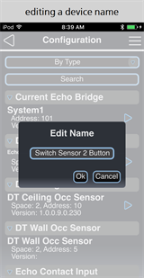

Configurable devices display a blue arrow on the right side of the device name. Devices in the list with a duplicate address will indicate with a red exclamation point on the right side of the device name.
From this page you can also wink a device, both configurable and non-configurable device types, and change a configurable device's name from its default. Swipe left to access a device's wink and edit buttons.
A blue arrow located on the right of a device name identifies a configurable device. Tap to select the device name to display its configurable properties for customization. Click on the following device names to learn more about their configuration parameters.

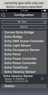

By default, the devices list displays its discovered devices sorted By Space then by the device address (e.g. all devices in Space 1, lowest address to highest, then Space 2, etc). Additional sort options include By Address and By Type. Change the sort by selecting the option from the available drop down list.
Sorting by type sorts devices into device categories that can be expanded and collapsed.
