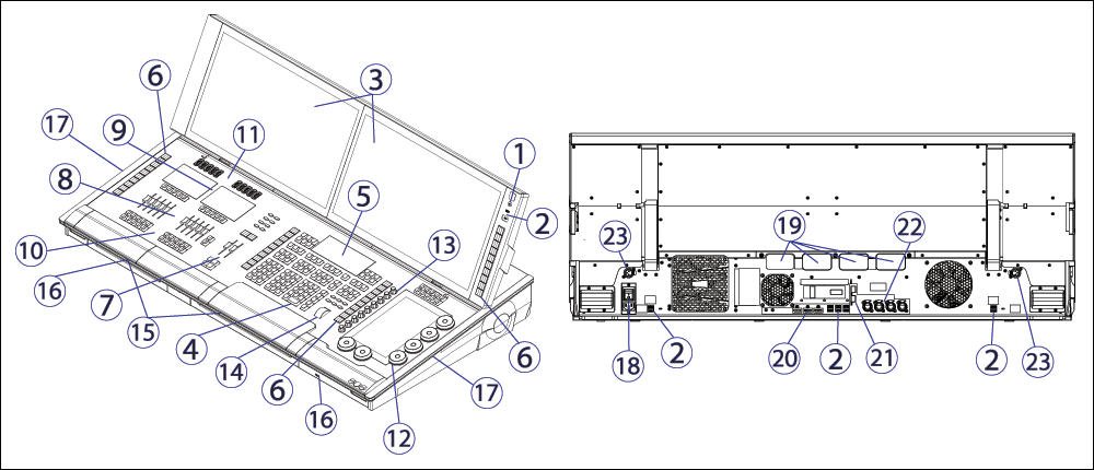

This page provides an overview of the physical layout, components, and capacities of the Eos Apex 10 console.
Eos Apex 10 Layout
1. Power button
2. USB-A & USB-C (data)
3. Internal touchscreen
4. Keypad
5. Keypad touchscreen
6. Target keys
7. Main playbacks
8. Motorized faders
9. Fader touchscreen
10. Configurable fader buttons
11. Endless fader wheels
12. Encoders
13. Mini encoders
14. Level wheel
15. Keyboard / accessory tray
16. USB-A (power only)
17. Book lights
18. Hard power switch / IEC socket
19. IO garage
20. Display Port
21. SFP+
22. Ethernet
23. Littlite
