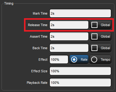

When you release a cuelist and fixture parameters go to their default values, they do so over the release time, and this change may be visible if you have fixtures that are visibly live on stage (i.e. with intensities above zero). To assign the cuelist's release time:
Open + Choose : open the Cuelist window for the cuelist on the selected master.
Options → Cuelist : open the Options window and select the Cuelist pane.
Alternatively, press Pig + Choose to open the Options window for the selected master.
Select the Release Time cell:
Set
5, Enter : assign the desired release time.

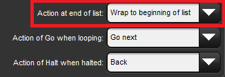

You can use auto release options to send fixture parameters to their default values at the end of a show, or to relinquish control of parameters for use by other cuelists when a cuelist is no-longer needed.
There are two Auto Release options for cuelists:
Auto-release at End: Use this to automatically release the Cuelist at the completion of the fade and delay times of the last cue.
Add Release End Cue: After the last cue has run another press of the Go key will release the cuelist rather than running the first cue again.
You can assign auto release options in the Playback Options window of each cuelist:
Open + Choose → Options → Cuelist
Select the desired release option from the Action at End of List menu:

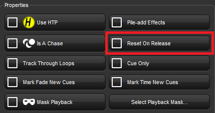

You can assign a cuelist to reset when released so it will proceed from the first cue when Go is pressed again. You can assign Reset on Release in the Playback Options window of each cuelist:
Alternatively, you can turn on Reset on Release for all new cuelists in the Cuelist pane of the User Preferences window:
Setup → Preferences → Cuelist
