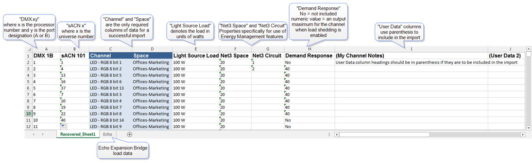

Reference the sample load schedule below for an example of a clean import file:
TIP: When using the OpenOffice freeware application to edit or create your spreadsheet, be aware that editing the "sACN" column name will result in the application automatically changing the name to include a capitol S ("SACN"). This is invalid and will not import into LightDesigner. You must change it back to "sACN" for the import process to complete.
Any extra columns of User Data to be imported should be designated using parenthesis around the column header , for example (My Channel Notes) as indicated in the sample above. All provided row data will import with a valid column header. In addition, when imported, the provided header name overwrites the User Data label in the property editor.
Other included data in the load schedule spreadsheet formatting is ignored by the import process. A simple way to see an example of a Load Schedule is to begin by exporting a load schedule from an existing configuration.

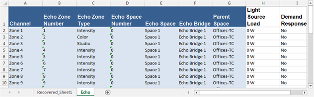

Echo Expansion Bridge
A second tab in the import load schedule spreadsheet can be enabled for Echo Expansion Bridge configuration data.
The data columns must include the following headers and supporting data for a successful import:
* Not required for a successful import.

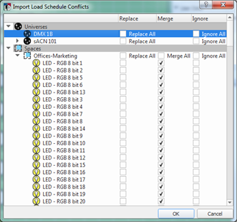

Importing Conflict Dialog
The import process could result in a conflict with pre-existing configuration data causing a "Import Load Schedule Conflicts" dialog to display for specification of replace, merge, or ignore. There are multiple reasons a conflict can occur, with a main reason being a duplicate object of the same name; importing a file twice will not create the objects in duplicate. Instead you are provided with a conflict dialog for disposition of which version of the same object you would like to maintain.
You can submit an action per conflict or a set an action that will affect all conflicts at once.
After the import is completed successfully, there may still be errors incurred by the import. Check the Error Browser for a list of any incomplete assignments that may affect the configuration.
