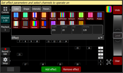

How to Apply an Effect
  1. Select some fixtures.
  2. Go to Controls>Effects
  3. Press Add Effect.
  4. Choose an effect type from the tab area.
  5. Select a pattern.
  6. Adjust the effect settings for the desired result. The available effect settings change based on the effect type selected.
Note: The order in which fixtures are selected is relevant and will affect the behavior of the fan setting.
To remove an effect, press the Remove effect button.
Effects can be stored to cues and playbacks. When effects are played back, a symbol is shown to the right of the stage map display corresponding to each effect currently in operation. You may pick this symbol and adjust the depth of the effect on the wheel, edit, or stop it.
